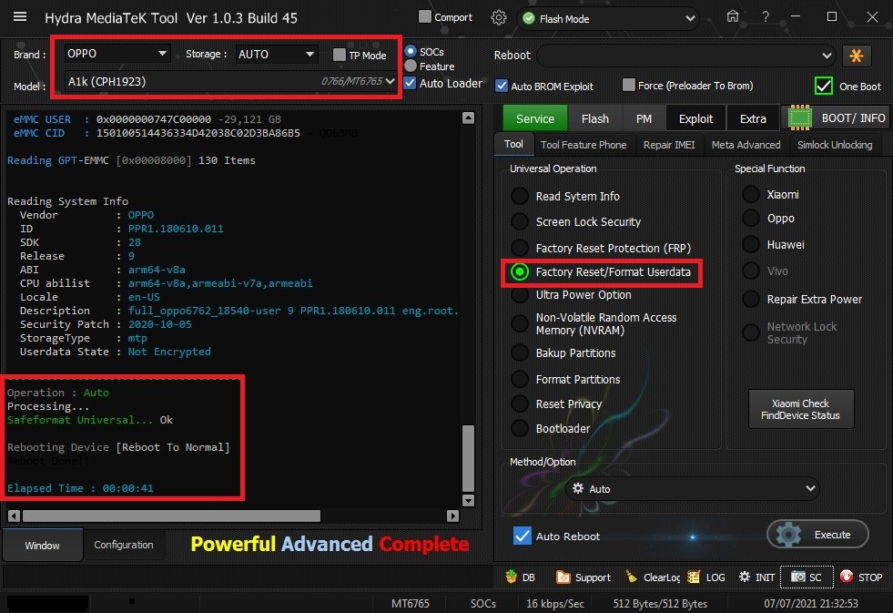

حذف قفل الشاشة بدون فقدان البيانات OPPO A1K

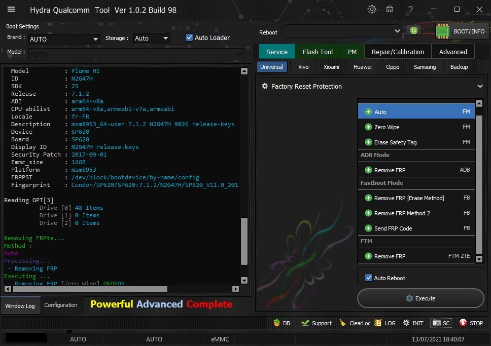

Condor Plume H1 (SP620) Ultra Power Option
[B][FONT=Arial Black][SIZE=2]PreOperation Configuration
 Brand : CONDOR Model : Plume H1 Storage : Auto
 Loader: Mi_8953.mbn
 Port  : Auto
 Searching for Qualcomm 9008 Device...Found
 FriendlyName :Qualcomm HS-USB QDLoader 9008 (COM42)
 SymbolicName :\??\USB#VID_05C6&PID_9008#6&12e3c9ed&0&1#{a5dcbf10-6530-11d2-901f-00c04fb951ed}
 Driver Ver   :08/31/2015,2.1.2.0
Getting device info..Ok
Device MODE : Firehose
Connecting to Firehose...
Ping.. Ok
Configuration......
Identifying Chip....
Ok
Chip Configuration :
 MemoryName : eMMC
 MaxPayloadSizeToTargetInBytes : 1048576
 MaxPayloadSizeToTargetInBytesSupported : 1048576
 MaxPayloadSizeFromTargetInBytes : 4096
 MaxXMLSizeInBytes : 4096
 TargetName : 8953
 Version : 1
*** STORAGE DEVICE INFO ***
Memory Type         : eMMC
Block Size in Bytes : 512
Page Size           : 512
Manufacturer ID     : 144
Serial Number       : 934817224
Firmware Version    : 165
Product Name        : HAG4a2
Physical Partitions : 3
Total Logical Blocks:
          Drive [0]  30777344[14.676 GB]
          Drive [1]  8192[4 MB]
          Drive [2]  8192[4 MB]
Protocol : Universal
Running : Ok
Reading GPT[3]
          Drive [0] 48 Items
          Drive [1] 0 Items
          Drive [2] 0 Items
[COLOR="#008000"]Phone Information.....
  Brand          : Condor
  Vendor         : SPA Condor Electronics
  Model          : Plume H1
  SDK            : 25
  Release        : 7.1.2
  ABI            : arm64-v8a
  CPU abilist    : arm64-v8a,armeabi-v7a,armeabi
  Locale         : en-US
  Description    : msm8953_64-user 7.1.2 N2G47H 2578 release-keys
  Device         : SP620
  Board          : SP620
  Display ID     : N2G47H release-keys
  Security Patch : 2018-03-01
  Emmc_size      : 16GB
  Platform       : msm8953
  FRPPST         : /dev/block/bootdevice/by-name/config
  Fingerprint    : Condor/SP620/SP620:7.1.2/N2G47H/SP620_V11.0_20170925:user/release-keys
[/COLOR]
Processing Auto....
[COLOR="#0000FF"] - Removing FRP
[COLOR="#008000"]Executing ...
[/COLOR] - Removing FRP [Zero Wipe] [COLOR="#008000"]OkOk[/COLOR]
 - Formatting Userdata
[/COLOR] - Formatting Userdata  [Safe Format - eMMc] [COLOR="#008000"]OkOk[/COLOR]
Action Result : [COLOR="#008000"]Ok[/COLOR]
[/COLOR]Rebooting Phone.... Ok
Elapsed Time : 00:00:03
[/SIZE][/FONT][/B]

Condor Plume H1 (SP620) Remove FRP Done
